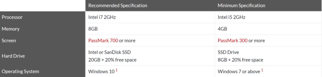

  • When I open the Capture Visualiser workspace, I am presented with the following
    ‘Capture Library Not Installed’. How do I resolve this?
    Check the fixture library has been installed correctly. If you need to re-install this please visit personalities.avolites.com
    Also, please check your machines graphic cards are up to date and meet the minimum spec. requirements below:

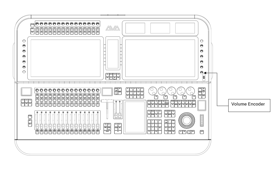

  • The bottom right rotary pot next to the display on the Diamond 9 does not respond in Titan. How do I fix this?
    The rotary pot located to the bottom right of the D9 display is a dedicated volume control for WinAmp and has no function in Titan.

  • When I run Ai the screen is black.
    This generally happens when Ai is run on a system which does not meet the required specification for the graphics card – often this will be due to an Intel graphics chip with shared memory.
    Unfortunately these are not supported in Ai as they lack some of the higher functions required of the GPU that Ai makes use of. If you do have both a shared and dedicated GPU in your machine, make sure that Ai is set to run on the dedicated GPU – this can usually be done via the control panel for the graphics card.
    Please refer to the minimum required specs for further information.
