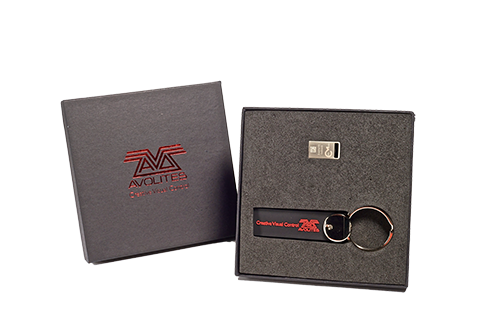

‘Internal’ and ‘External’ AvoKeys
Counterfeiting is a major threat to innovation and creativity in our industry. Developing software licensing and encryption is not something that excites us, but as we must regularly change our passwords and lock our doors, it is vital we protect our IP. To do this, we have introduced the AvoKey. The AvoKey is a USB dongle that plugs into your console or laptop and allows you to upgrade to Titan v12 and above or Ai v11 and above.
If you do not wish to upgrade your software, it is not compulsory. Titan v11 and Ai v10 will run without an AvoKey and point versions have been released to ensure the software performs at optimum level.
To ensure you have the right AvoKey for your product, check the AvoKey selection and Installation guide below.
To purchase an AvoKey, contact your local distributor or Avolites directly.
What types of AvoKey are there?
There are three different types of AvoKey:
AvoKey Collection – A1+, A2+ & A3+ AvoKeys plug into any laptop to unlock v12 and above simulator and v12 on your old Titan One Needed for: Titan One, V12 and above Simulator
Part Number: view dedicated website
External AvoKey – Silver AvoKey that plugs into your laptop to access v12 and above on your Titan Mobile or Ai License (please note the Ai license will be loaded onto the AvoKey, you will not need your old Ai license to access Ai v11 and above). Needed for: Titan Mobile, Ai License Upgrades
Part Number: 31-30-0020
Internal AvoKey – Red AvoKey that plugs into your console or media server. Additional cables may be required for your console. To find out more, please check the AvoKey selection guide below. Needed for: Consoles from the Quartz onwards, Media Servers.
Part Number: 31-30-0021
Please check the AvoKey selection guide below and note that the key is locked to one console only, and cannot be shared.
