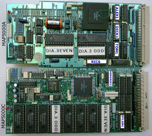

Diamond II & III
PCB NAME GAL NAME GAL DEVICE
Map – new type Dylan1 16V8
Map – new type Hendrix2 isp2032
Map – old type Tom001 16V8
Map – old type Dick001 16V8
Map – old type Alex-001 16V8
Map – old type Ric-006 22V10
OPX Alicia4 16V8
OPX Benita3 20V8
S2L PoppyT3 16V8
DC2 Mandy3 16V8
ECPC Hector2 16V8
WCE Encg0001 12 Off 16V8
AKS AKSV1.1 Zilog 86E211
Download
FILE NAME FILE SIZE
dia-mapnew.zip  3.68 KB Download
dia-mapold.zip  4.25 KB Download
Not sure which Map card you have?
Click here to see a picture of both Map cards.
Avolites MAP Eurocards
There are two types of Eurocards on Avolites products.
The eurocard at the top is the ‘old type’ MAP5000A whilst the one at the bottom is the ‘new type’ MAP5000:
